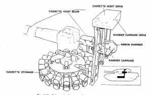

Is it possible for carousel type autoloader to use long rod penetrator effectively due to limited size of autoloader?I heard that this is major disadvantage of carousel autoloader that it can't match length of western size long rod APFSDS rounds as autoloader can't hold it and so penetration capability is lesser.

The caroussel loader works with 2-piece 125mm ammo. Hence the disadvantage relative to single piece 120mm rounds.

Carousel autoloader inside a tank is limited by the round size. As the bigger/longer the round is, the larger carousel is needed. The disadvantage you are talking about exist as all carousel loader work in a 2-pieces fashion. (Basically break down a round into projectile and charge) to lower the diameter you need for the carousel.
But most of all the autoloader is hampered by one major issue other than the carousel itself, but the safety of the round. As there are no way a gunner can jam the gun on a single piece manual loader (Actually, it can, I saw once by the fine work of a US Army Gunner.......). But this can happen when you are using an autoloader. Hence the charge used in the autoloader system tend to be less powerful than a single piece round, thus preventing excessive gas and explosive residue and back fire the gun.
