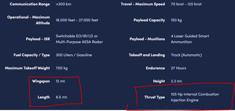

Now the length and wingspan of this UAV is quite similar to TB-2. Furthermore, TB-2 is also powered by a 100hp engine, so it makes a natural comparison. Some specifications stick out:
Length - Wingspan [m]Engine Power [bhp]Payload [kg]Endurance

The airframes are similar in size but Shahpar-II is a good 200 kg heavier and has HALF the endurance. You could put this out to very primitive airframe design but I doubt that that is the case here. I know that pretty advanced/contemporary techniques are used for Shahpar-II. What is more likely is that Shahpar-II is currently flying with an undersized (for it) engine.
All of this would explain:
1. Why Shahpar-II has such a low endurance - it has to operate near or at maximum setting throttle, making it fuel inefficient.
2. Why Shahpar-II has a high MTOW - for reason 1 it has to carry more fuel to achieve a half-decent endurance

I'd like to add a few minor additions to help you compare: TB2 acceptance tests were conducted in 2014. TB2 completed its first fully autonomous flight test on April 29, 2014. In tests on 14 June 2014, an altitude of 27,030 feet (8,240 m) was reached with MTOW / full load. In the flight test carried out on 5-6 August in the same year, it traveled 4,040 km at an altitude of 18,000 feet (5,500 m) with full load and remained in the air for 24 hours and 35 mins. However, over the past 7 years, the TB2 system has undergone major enhancements several times. Over time, improvements were achieved in load capacity and flying time.
With these improvements, a wide range of uses emerged, from the communication/signal, navigation relay to the classic air support role. These systems are inexpensive, easily available, and truly hard-to-detect tactical systems. So I have full faith that Shahpar-II will have a great career; as long as the PAF can put forward a correct doctrine that can make the most of these planes for its unique circumstances and geography.
We defense industry enthusiasts always like to talk about numbers, but if you ask me, the most important factor that increases the power multiplier of these weapons is unique doctrinal approaches which specialized for UAVs.
No, I am not forgetting the square-cube law.
If Shahpar-II with the Rotax 912 has "absolutely zilch chance" of taking off, how do you explain the Bayratkar TB-2 taking off, which as I pointed out, has almost the same same dimensions and a 100 hp piston engine?
To further my point, a 100 hp engine on aircraft cruising at 80 kts will produce 1600 N of thrust. Now consider the absolute worst case weight of Shahpar-II: MTOW of 800 kg. This yields a T/W of 0.2. A little low T/W, yes; "absolutely zilch chance" of taking off, no. Many aircraft have T/W of 0.2.
Of course, I can be wrong and there already is a turboprop in there, or it may be designed with one in mind and is currently flying with a piston engine. The reason that I would be suspicious of a turboprop is that we haven't seen that yet. But of course, there's always a first time. I don't know for sure, is what I'm saying.
Also, let me just add that I would expect a bigger payload and a higher cruise speed with a turboprop.

Thank you for those details! They are certainly insightful! The TB-2 makes a natural comparison for the Shahpar-II and presents where it may go in the future. I do wonder how the TB-2 is able to squeeze out that much performance for its size/engine. Can you comment on that?
