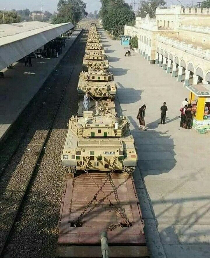

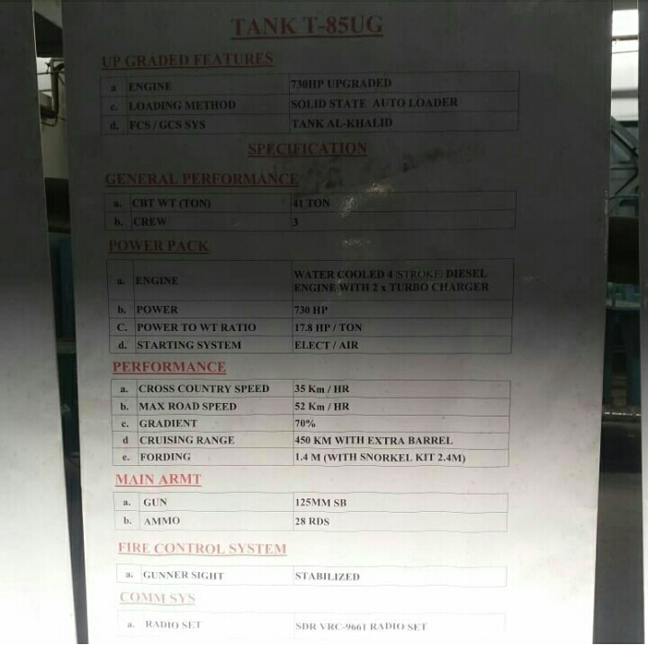

T-85 II upgraded is known as T 85 UG in Pakistan army standards , it has a new 730 hp engine , auto loader and FCS from al khalid .
( image taken by khizer mehmood )

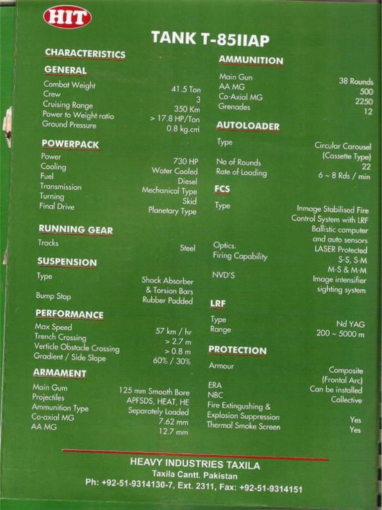

Old brochure of Type-85II
number of rounds for main gun decrease from 38 to 28 though the gun is still 125mm which is bit strange
Secondly max speed has also decrease from 57 km to 52 km, though in cursory look does not appear significant but the issue is engine horsepower, overall weight of tank is same which mean same power to weight ratio of 17.8 HP/Tonne so why the top speed has decreased ???
Secondly max speed has also decrease from 57 km to 52 km, though in cursory look does not appear significant but the issue is engine horsepower, overall weight of tank is same which mean same power to weight ratio of 17.8 HP/Ton so the top speed has decreased ???
I think 0.5 Ton is decreased

22 rounds in the carousel, 8-10 inside the ammo bins while the rest stored inside the turret. Removing those means that rounds are not scattered, which makes the vehicle safer in case turret or hull gets penetrated.
