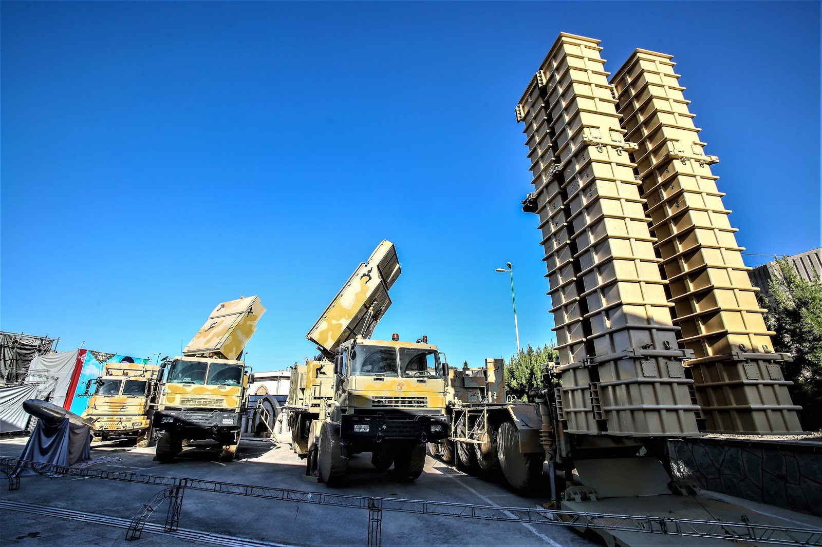

A battery of Bavar-373 includes 1 Acquisition radar, 1 engagement radar, 1 command and control, 6 TEL (each with 4 missiles) for a total of 24 missiles ready to fire.
A battery of Bavar-373 missile defence system[4]

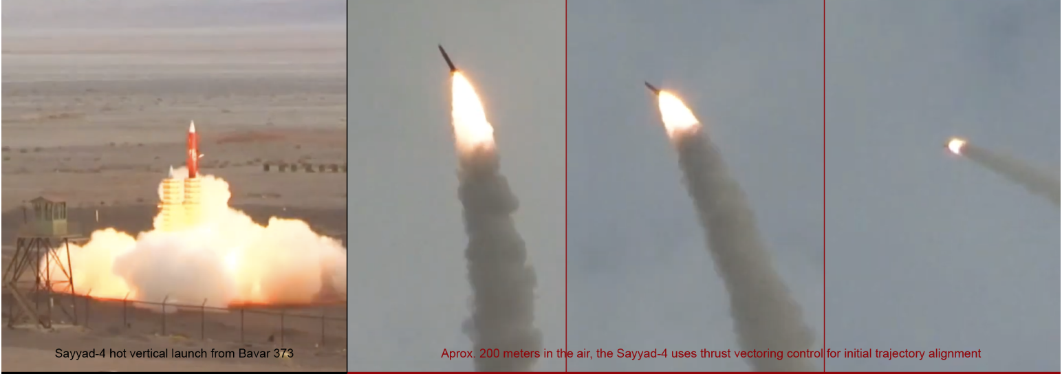

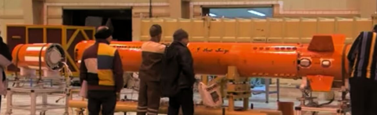

Bavar 373 utilises a missile called Sayyad-4. This missiles incorporates Trust Vector Control (TVS) and has a range of 200km and maximum engagement altitude of 27-30km.[3] The maximum speed of the missile is not known, however, it is capable of dealing with air targets flying at speeds up to 2800 meter/second ( around Mach 8). This missile has the ability (albeit limited) to also target ballistic missiles during their terminal phase.[3]
The missile is believed to be guided via Semi-Active seeker utilising Track Via Missiles (TVM) or Seeker Aided Ground Guidance (SAGG). The use of such a system over an active seeker provides the benefit of 1) Extra protection against jamming 2) Better capability against stealthy targets.[5]
Sayyad-4 missile[3]
Sayyad-4 during manufacturing stage.[3]

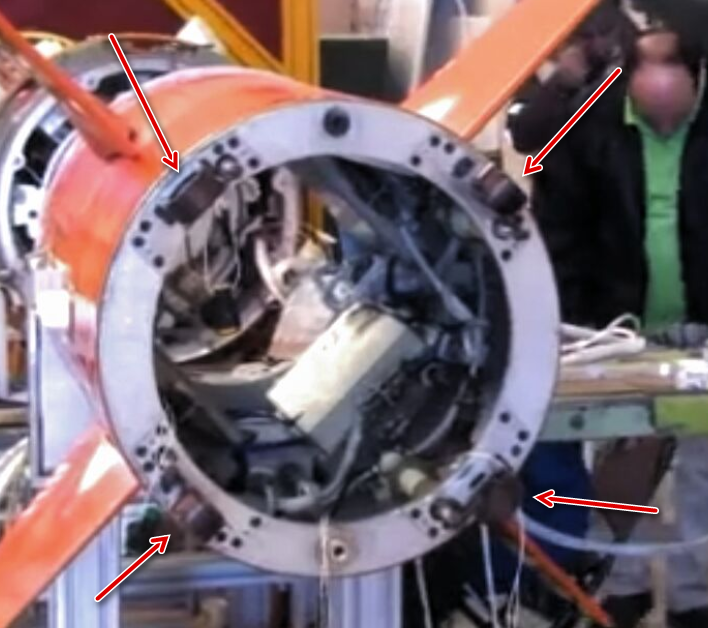

Thrust vector jet vanes will be inserted here.[3]
Sayyad-4 Trust vectoring during flight.[3]

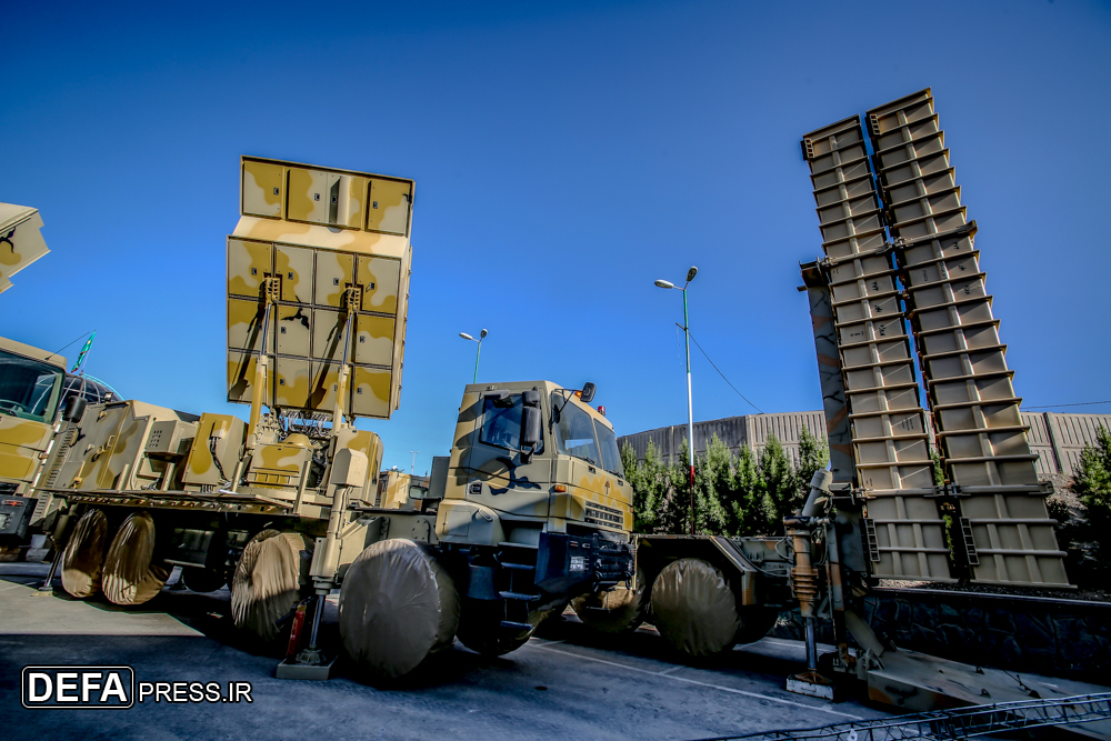

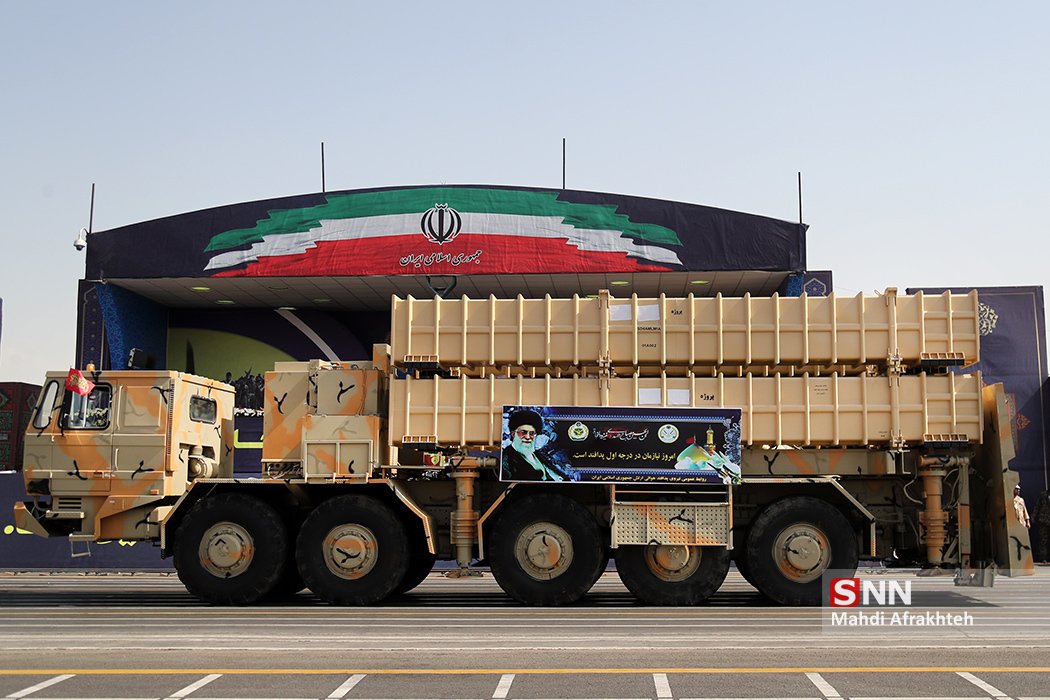

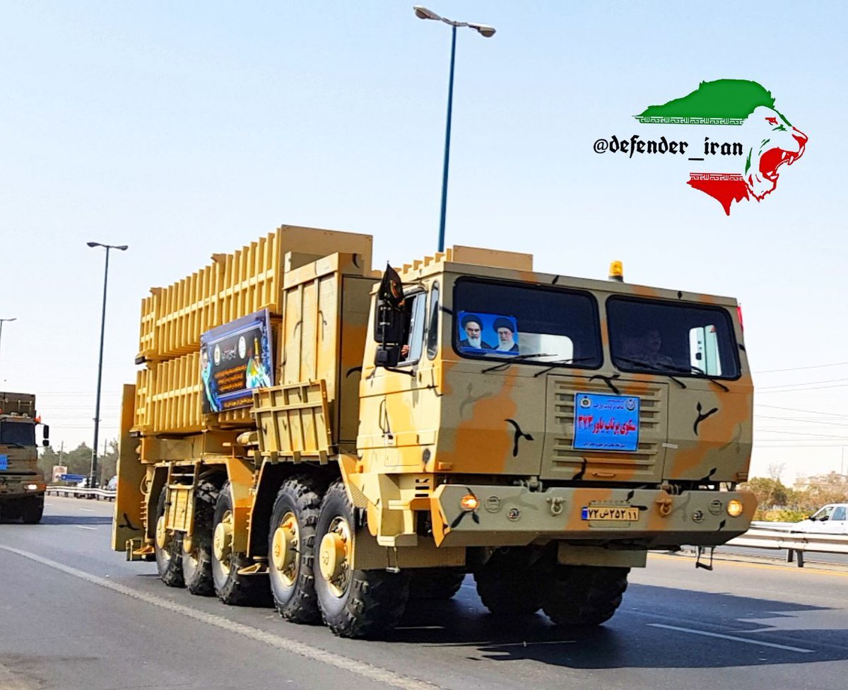

Launch platform:

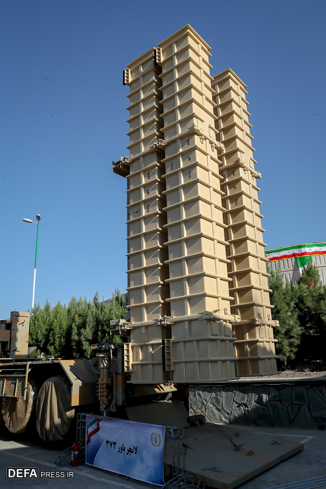

Bavar-373 uses the hot-launch method, where the missile engines are ignited whilst the missile is still inside the container tubes, as opposed to a cold launched systems where ignition is formed post gas instrumented ejection from the tube (such as in the S-300/400 series).[3]

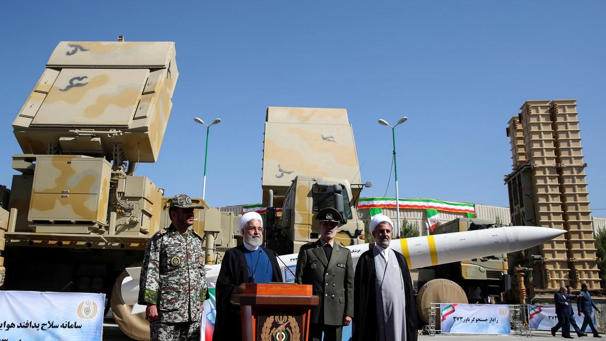

The boxed vertical launch systems of the Bavar-373.

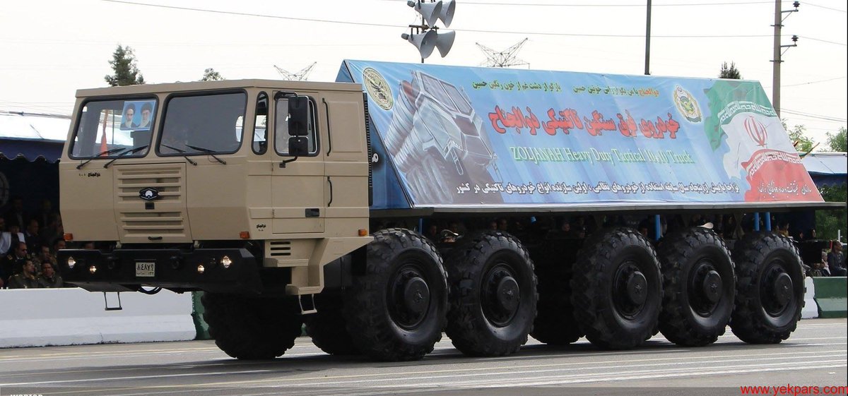

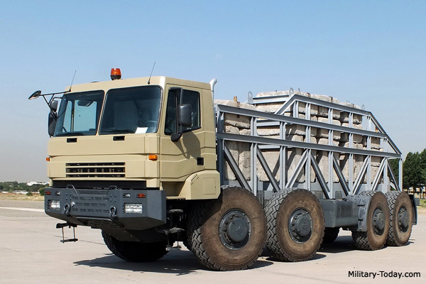

The Bavar-373 TEL uses the Iranian made "Zoljanah" 10x10 truck [5]:
Zoljanah 10x10 TEL[5]

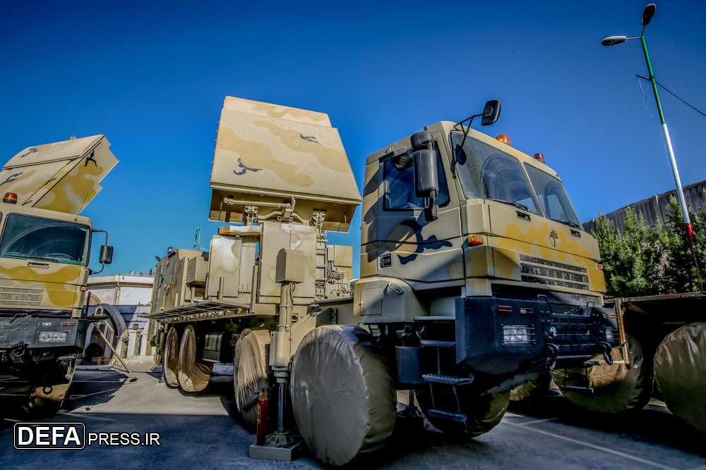

X-Band AESA radar
One of the radar systems used in the Bavar-373 is the X-Band AESA engagement radar. This radar is comprised of over 10,000 Transmit/Receive Modules (TRM). It has an engagement range of 200km and can direct 12 missiles to 6 targets simultaneously.[3]
On the left: The X-band AESA engagement radar.[2]
What is interesting about this radar system is its rather "3D" configuration. Although not officially confirmed, these angled potential subarrays seen below in Yellow could be part of a constructive wave interference method leading to increased power gain and range. Other possibilities for what they could be include: Side Lobe Cancelling (SLC) or data links.[5]
Bavar's X-band radar array, with main components highlighted. Main array in Red, possible sub-arrays in Yellow, and Identification Friend or Foe (IFF) array in Blue.[5]

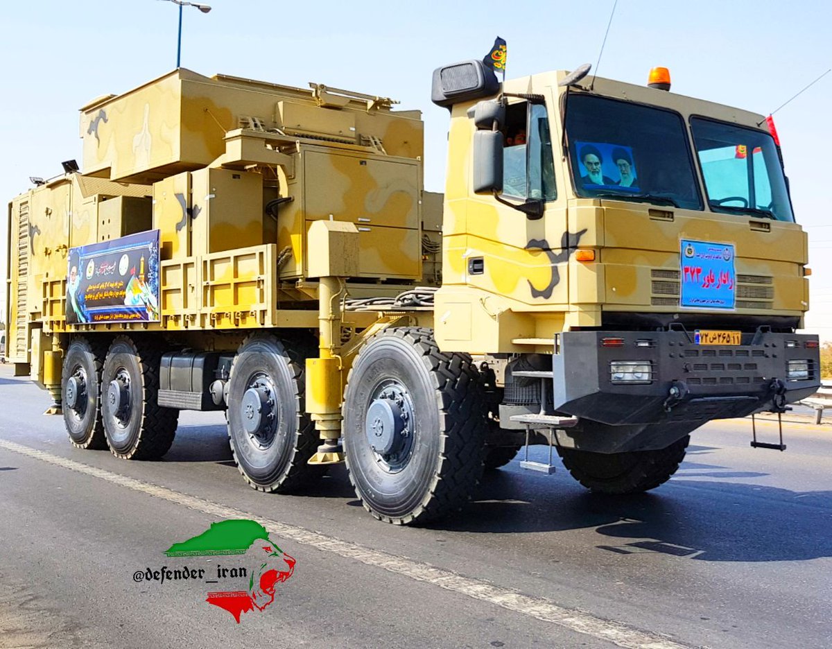

The TEL used for both of these radars is the Iranian Zafar 8x8 truck, shown below during its tests:
Zafar 8x8[5]
